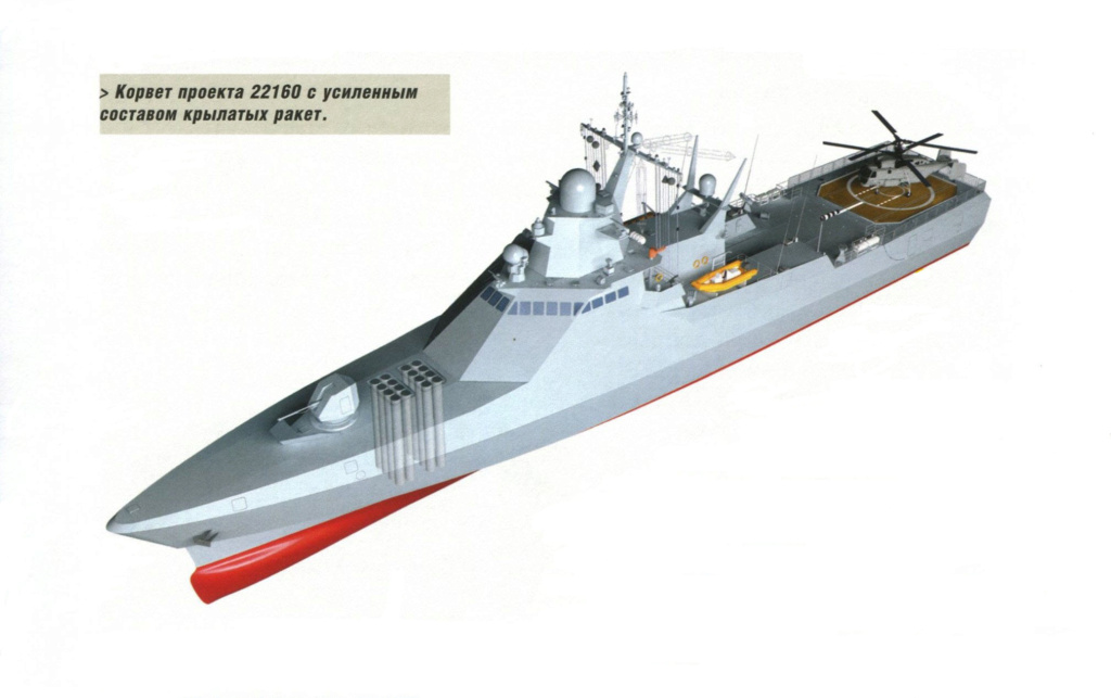

Dima- Posts : 1218
Points : 1229
- Post n°608
Re: Project 22160 Bykov-class patrol ship
IMDS 2021 showcased an already known variant of 22160 often mentioned in brochures, but I believe a better job can be done. I have many times mentioned the need for a mass produced, good, long range corvette/patrol asset for the Russian Navy based on the 22160 that's also properly armed. So did some rough illustration to show how it could look.
The above one is with decent AD layout, but misses out completely on the 8-cell configuration seen on 22500 (below). This is basically b'coz the hanger is fused into the superstructure and takes valuable space inside. They likely did not consider any "major" changes to the superstructure as they are still struck with the option of container based 8-cell configuration at the stern.
I have always wanted to remove these two stuffs and integrate the features of 22160 & 22500 into a single purposeful unit.
There are certain things that I have strong dislike for in the 22160 proposal (& the wasteful 20386). One of them is the container based silos.
I personally believe, any missile launches should be a one step process once everything is cleared. Open the hatch and Zooom!
Not a tedious 3-4 step process which involve helo deck clearing, opening the flight deck, opening the container, raising the silos to launch position to FINALLY fire the missile.
Its ok to utilize this method for ships which are not dedicated combat ships like landing/transport ships, but an utterly wasteful and ridiculous configuration for combat ships.
There is nothing groundbreaking in the configuration that I have illustrated below.
All the configuration was already illustrated in various models/brochures of 22160. I did the work of integrating it into a single unit.
For example - 8-cell configuration.
There was no chance for 8-cell to be configured transversely at the bow, as the lower decks doesn't have required beam (shorter AD silos can be accommodated). So they always showcased the 8-cell unit configured along the axis.
The main changes I made are -
1) pushed out the hanger completely from the superstructure to integrate a transverse 8-cell unit like 22500
2) done away completely with containerized launchers at the stern.

Dima- Posts : 1218
Points : 1229
- Post n°609

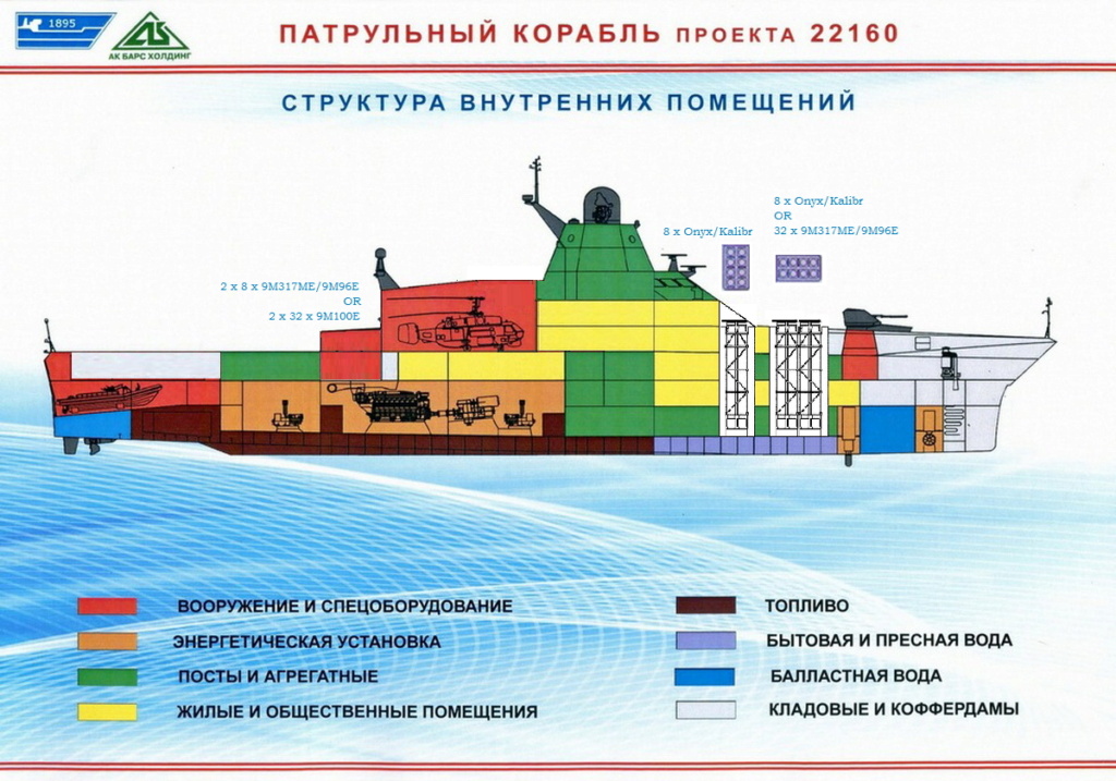

- Post n°612
I took that specific sectional self explanatory view from the brochure so as to avoid explaining much.Big_Gazza wrote:Is there any info available that details the current use of the hull space that you're allocating to VLS? Crew accomodation? Galley? Provisions storage? Equipment room? I think its fair to say that its not a big empty void that is just waiting for a shiny pair of missile bins to be slipped in and bolted down. Stability considerations might also be important.
Green - various posts
Yellow - crew & other public spaces like galley..
Red - weapons/equipment related
I don't have any specific details regarding those shown in the brochure. So the readjustments of green/yellow was based on my thoughts.
But, anyone with careful observation will be able to get that the hanger fused into the superstructure is taking a lot of usable space due to which those spaces found residence further ahead.
Also, I don't know if you were actually serious when you asked about the crew, public & other spaces.
Are you saying that you never saw or came across the below illustration of 22160 with 16 x 9M96E?
What happened to those posts, crew and public spaces when those 16 cells was installed there?
Where did they go?
Are the internals so tight that there is hardly any space to rearrange/maneuver?
I just want to repeat one again that, what I illustrated in the above is nothing ground breaking and is a rough one based on the various models/CG/sketches of the 22160 and 22500 made available all these years.
Or lets say, I dug at the same "empty" spaces where the designers had already dug, to display their various configurations, to bolt down the shiny pair of missile bins.
GunshipDemocracy and Mir like this post

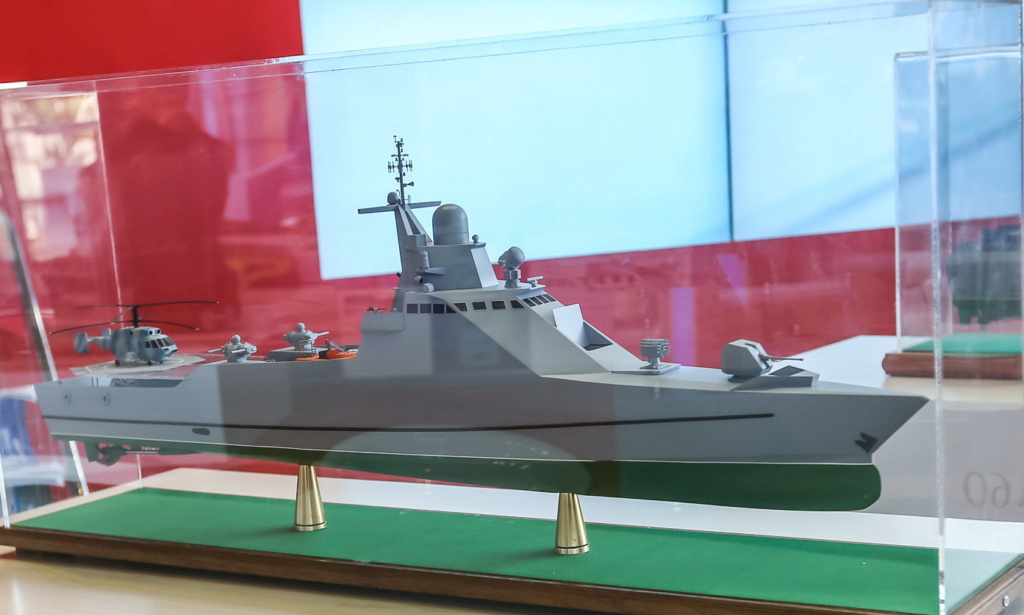

GunshipDemocracy- Posts : 5855
Points : 5879
- Post n°613
Actually 20160 could be better solution then 22800. More displacement, more weaponry and range if in corvette "edition".
BTW does anybody know what cells are on stern? Redut ones?

hoom- Posts : 2353
Points : 2341
- Post n°614
I addressed that in
https://www.russiadefence.net/t6657p575-project-22160-bykov-class-patrol-ship#328530
and
https://www.russiadefence.net/t6657p575-project-22160-bykov-class-patrol-ship#330650
In that model there are 24 cells so would presumably be the proposed all Redut version.
While its attractive to theorise about filling-out the 22160 & turn it into a proper warship (and I've certainly indulged in it), I think that hull design has issues with extra mass.
Once you're pushing 2000ton there is already a proper warship in that weight-class in production & its got proper ASW capability -> makes more sense to just build more 20380/5s IMO.
and

Poorly worded but he means 1 engine room.Actually all sources i could find say there are 2 Kolomna 16D49 diesels.
Proper military spec would separate them with waterproof bulkheads so that if one is damaged/flooded the other may be OK.
GarryB- Posts : 37234
Points : 37750
- Post n°623
That was one of the Russian Navies objections to the Mistral design... only one engine room...

no no this is not as incorrectly placed post. At the end of IZ article you can find interesting news:
Special attention is now being paid to protecting ships from air attacks. Izvestia has already written that the Navy is working on the parameters of a contract for the purchase of a new batch of Project 22160 Vasily Bykov patrol ships. They will have to be built according to the updated project. They will eliminate weaknesses identified during operation - including during trips to the shores of Syria and the Arctic. In particular, the ships' armament complex will be revised on them. It is possible that the ships will be equipped with a new air defense system. In total, six Bykovs are to be built by 2023.
Looks like VLS for Redut and UKSK are going to be added after all. My bet is on 2 more diesels ( so there will be 4 as planned -> top speed 30kts)
edit: of course in mock up were also 2x paket torpedo launchers
Here about Bykov using Ka-27 and future exercises with Kalibrs
