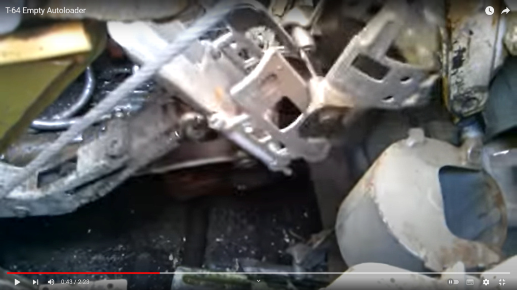

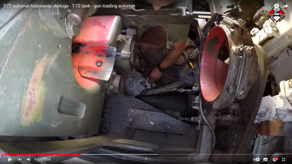

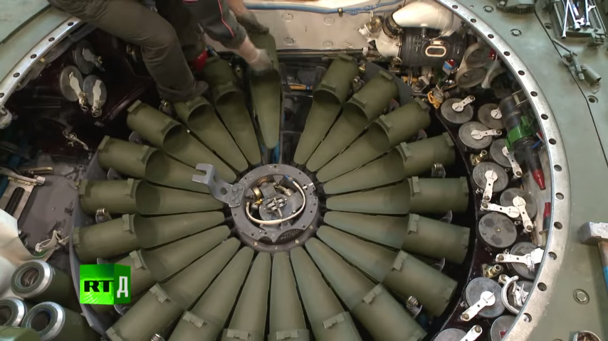

    Post  ALAMO Tue Feb 07, 2023 9:35 pm
    Again, as some more mythology was unleashed on you ...
    Let me show the principles.
    T-72 ΜΒΤ modernisation and variants #2 - Page 5 Carous10
    This is a T-72B type carousel hub. In theory, the same one as for T-72B3/2016.
    But here you have the one from new T-72B3M (?)
    See the central hub diameter difference?
    Now let's follow ...
    Look here.
    T-72 ΜΒΤ modernisation and variants #2 - Page 5 Zrzut_45
    Do you see?
    The carousel rack is made exactly the size to match the opening.
    What you see in the middle, is ammo memory. This unit registers the ammunition load, and allows the fastest way to load it after. And - in general - load the round you ask on the selection panel.
    Here is the same unit for T-72B3/2016 :
    T-72 ΜΒΤ modernisation and variants #2 - Page 5 T-72b310
    Do you see the difference? It is much smaller, so the rack opening is nit much relevant anymore. It can host a longer ammo.
    And one more :
    T-72 ΜΒΤ modernisation and variants #2 - Page 5 Zrzut_46
    T-72 ΜΒΤ modernisation and variants #2 - Page 5 Zrzut_47
    T-72 ΜΒΤ modernisation and variants #2 - Page 5 Zrzut_48
    A loading sequence for T-64/80 series.
    As you see, there is not a single issue with round length considering the carousel. It can host double the size round easily.
    What is a case, is a gun breach, that blocks the longer round to be loaded.
    That is why the patents of 2005, 2007 and 2009 carried the rack construction, not a carousel itself.
    There is a space enough to put your mother in law there ...
