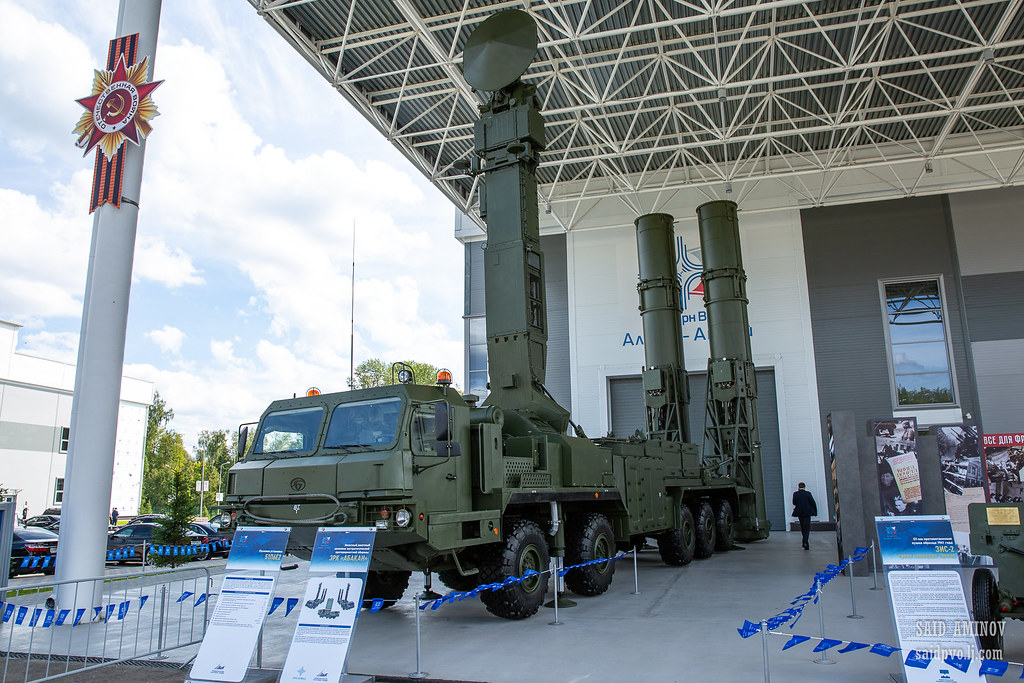

Isos wrote:It seems to be a new system.
What is interesting is that the information chart only shows two twin launchers for the bigger missile.
In the original system the bigger missiles are used against ballistic targets over longer distances, while the smaller missiles were used against cruise missiles and bombers and fighter aircraft, so this new system is perhaps being pitched as a light mobile ABM system... a sort of Russian THAAD... but obviously cheaper and more capable...
Isos- Posts : 7150
Points : 7136
- Post n°259
Re: S-300V Army SAM System
S-300V versions are meant to follow the ground forces. This seems to be an ABM with the S-500's radar to protect against 3000km range or less ballistic missiles targets like cities or high value targets but not strategic ones. That's why it is wheeled.
It's called "Abakan" according to the picture btw. I would say it's a cheap and less capable S-500. THAAD is a strateguc defence system, this one is not.
I think you should move it into the S-500/400 thread.

But the truck has the mast-mounted radar which is normaly associated with the smaller missile (to be able to shot down cruise missiles and low-flying aircraft)
Isos- Posts : 7150
Points : 7136
- Post n°262
Hole wrote:But the truck has the mast-mounted radar which is normaly associated with the smaller missile (to be able to shot down cruise missiles and low-flying aircraft)
Are you serious ? See your post 240. I though the same back in the time and you showed me this pic

I thought this would be Antey-4000 but it is Abakan, sorry. It seems a wheel based S-300V4, missiles are 9M82MD3 according to the chart, and the canisters are externally identical to those. It may make perfect sense, since the S-300V4 missiles were specifically designed against BM and proved to be very good, so it would be logical to use them also for the protection of fixed targets and not only of ground forces.

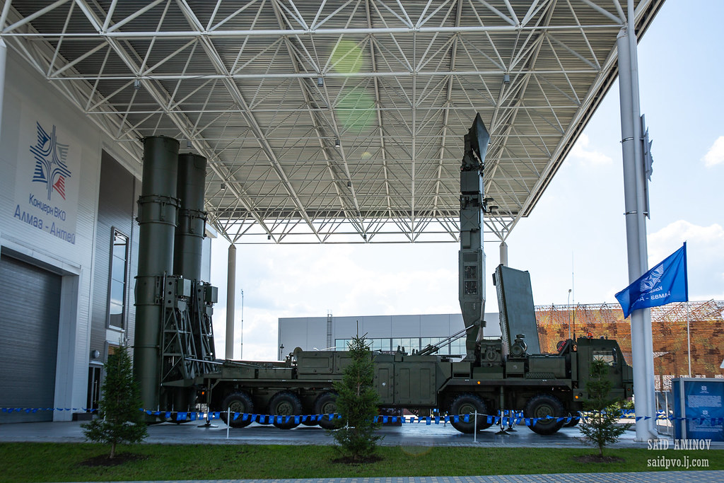

Isos wrote:Hole wrote:But the truck has the mast-mounted radar which is normaly associated with the smaller missile (to be able to shot down cruise missiles and low-flying aircraft)
This radar can´t be erected.

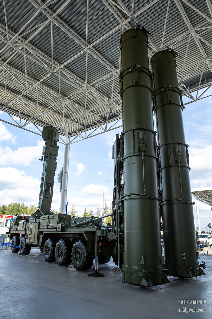

PU 51P6E2 SAM "Abakan"
Quote from the press release of the Almaz-Antey VKO Concern:
Highly mobile multichannel anti-aircraft missile system of non-strategic missile defense 98Р6Е "Abakan" is designed to engage modern and future non-strategic ballistic missiles in the defense of strategic important military-industrial facilities, government and administrative state buildings.
Official information on launchers and air defense systems.
The poster of the air defense missile system depicts an MFRLS with two launchers. The developer of the air defense missile system is NIEMI (as part of the NPO Almaz), and the PU is the Machine-Building Plant. Kalinin (MZiK).
Judging by the posters, the main means of destruction of the complex are 9M82MDE anti-aircraft missiles, which can also be used in the Antey-4000 air defense system.
Basic performance characteristics:
Max range of destruction of OTR - 30 km
Max height of destruction of ballistic targets - 25 km
Number of 9M82MDE missiles on launchers - 2
SAM preparation time - 7.5 s
Interval between launches - up to 2 s
Mass of launchers with ammunition - 53.5 t
Combat crew - 2 people
Deployment / collapse time - no more than 6 min
Max movement speed - 60 km / h
The presented PU and SAM "Abakan" are exclusively a product for a foreign customer. At present, the VKO Concern is actively promoting anti-aircraft systems and complexes created in the process of deep modernization of the S-300V air defense system. These are Antey-2500 and Antey-4000, attached to the 9A383E launcher for the Viking air defense system, and the new 51P6E2 launcher with anti-missiles. To be continued!
https://saidpvo.livejournal.com/978578.html
For a country like India where its potential enemies are on its border it will be missiles of ranges of 3,000km and less that will be the problem.
The only reason the S-300Vs are tracked is because they have to operate with army units that are also tracked. The Air Force equivalent is the S-300P which of course is wheeled.
Will be cheaper, but is also probably available sooner as it is a for export mobile ABM system.
Will be interesting to find out its performance specs... it should be able to match S-400 because that is its Air Force equivalent... 4.8km/s targets?
THAAD does not have the performance to engage strategic missiles... isn't the TH for Theatre... as in theatre based ABM system.
Both would likely be placed to defend major airfields and cities and HQs or government or ports etc...
The Russians wont use it as a strategic system, but export countries likely will.
It is clearly S-300V related, and fits here. The S-500 will likely be split out of the S-400 thread as more info becomes available too.
My understanding is that that radar antenna on the pole on both launchers is a data link used to communicate with the missiles in flight and don't scan or track targets as such. They have separate and rather large search and tracking radar vehicles...
The S-300V4 is a good system but its tracked chassis make it more expensive to operate and own... I think a wheeled family would appeal to more potential users... and certainly make it more mobile and cheaper to operate and own...
AFAIK they are datalink antennas. The one for the cruise missiles and low flying fighters or bombers benefits from being elevated when engaging low flying targets so the missile going after such targets can maintain communication link (line of sight), but for ballistic targets if the target gets so low the datalink can't communicate with the intercepting missile it is already too late...

Illuminator radars
