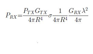

A radar system transmits energy towards a direction and then receives the amount of energy that is backscattered. This returned energy is called PRX, and is given by Equation
But the output of the radar receiver includes this signal plus ambient ther-man noise and receiver noise. Therefore we use a figure of merit called the signal to noise ratio (SNR) in order to define the receiver's sensitivity. In other words the ability of the receiver to output the backscattered signal correctly.A detection is defi ned by probability theory and exists when the incoming signal exceeds the detection threshold. A threshold is set that is a function of P`d and P`fa.
There is a relationship between SNR, P`d and P`fa.
P`fa can be reduced by advanced signal processign techniques. This means that R’ max can be increased
The heat emissions from the engines is present all the time.
receiver sensitivity
rcs is airframe, radomes, cockpit
