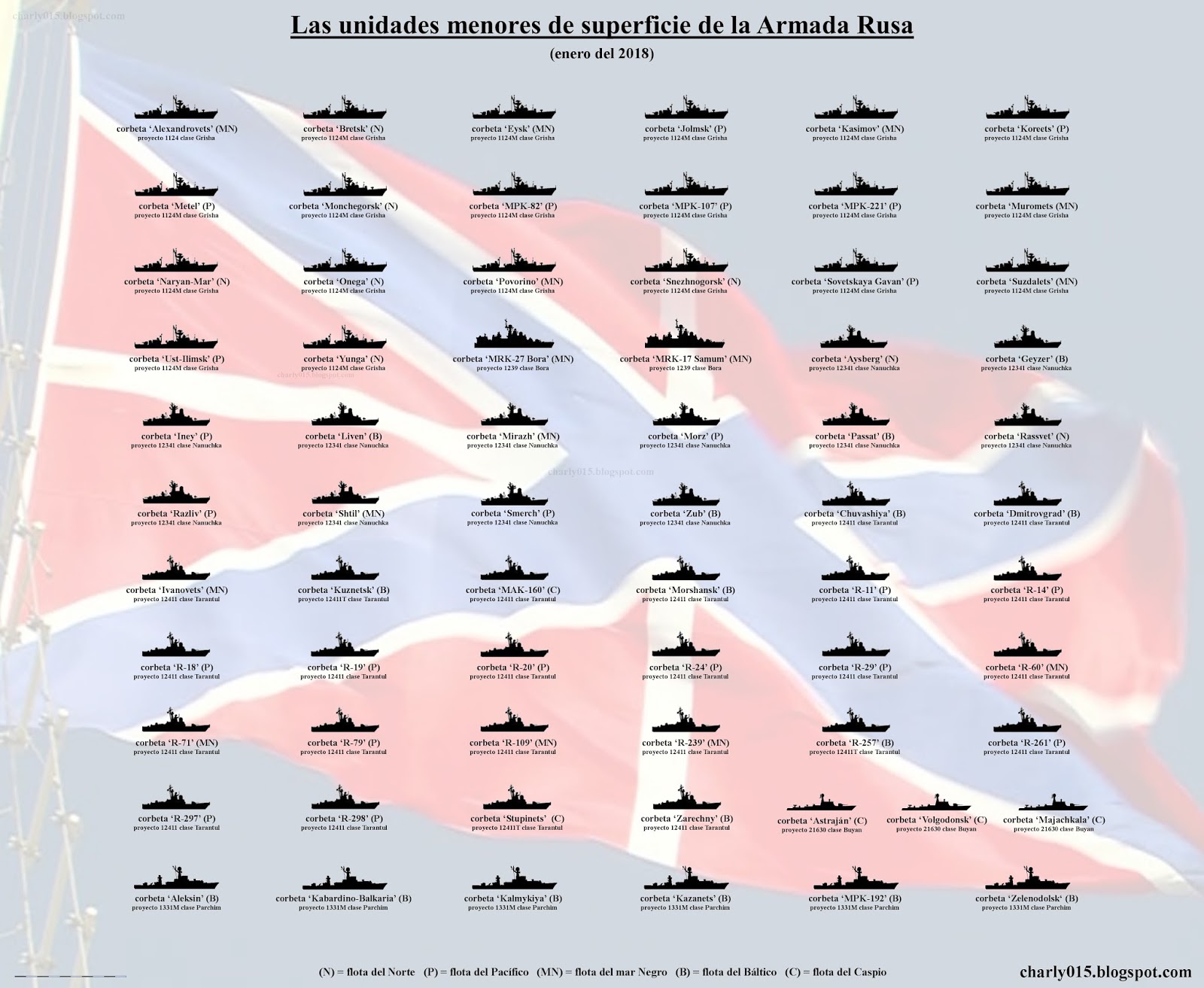

So in terms of replacing 1:1 by Charly015 count http://charly015.blogspot.com/2018/07/los-graficos-de-la-armada-rusa.html there are currently its 36* Nanuchka & Tarantul
so the planned 12* Buyan-M & 18* 22800 actually does come fairly close to 1:1, just needs another batch of 6.
