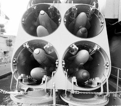

    Udaloy and Sovremennyy destroyers - Page 25 Metel-10
    The Udaloys have now been reclassified as Frigates. Same story they are multirole ships with an ASW orientation. The only difference is that they will be far more capable ships than before. Even the loss of the Mach 3 missiles on the Chabanenko is no biggie as they can use Kalibr missiles in the UKSK launchers - not to mention the Tsirkon and Kalibr-M'!

    The Udaloy's have always been "multirole" but with an orientation towards ASW
    No... the anti ship capability of the Metel was for self defence only... they were anti sub ships only.
    As you know the Metel was dual capable with one type missile with a seeker and a separate warhead for anti-shipping missions out to 90kms.
    Your photo reveals only half the missiles had anti ship capability while all 8 ready to launch missiles could attack sub targets with the torpedo slung under the rocket upper portion.
    The other type was guided by a radio signal and had a separate torpedo slung underneath.
    Both missiles carried torpedos and both could be used against subs, but one type could also be used against ships with passive IR homing.
    When attacking a ship target the 300kg warhead in the torpedo carrier together with the warhead of the torpedo and the torpedos fuel would be pretty effective against most ship targets. When attacking a sub the torpedo is released near the location of the target and the torpedo carrier just flys into the water and has no purpose.
    The missiles with IR sensors were more expensive but enabled the Ships to defend themselves from enemy ships.
