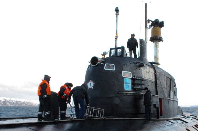

franco- Posts : 6266
Points : 6292
- Post n°91
Re: Project 945: Sierra class
I count 4 "fins".
Big_Gazza- Posts : 4358
Points : 4350
- Post n°92
franco wrote:I count 4 "fins".
The 4th boat is a 671RTM/RTMK Victor III. Obninsk or Daniil Moskovskiy I expect.
franco, George1 and Mir like this post
ALAMO- Posts : 5504
Points : 5598
Join date : 2014-11-26
- Post n°93
Exactly. The last one to the camera.
We see 945 in the front, followed by 2x945A, and some 671 in the background, Moskowski as I have seen the previous material already.
BTW, it is B-239 Karp that is missing, sitting at Zwiezdoczka and waiting ...
