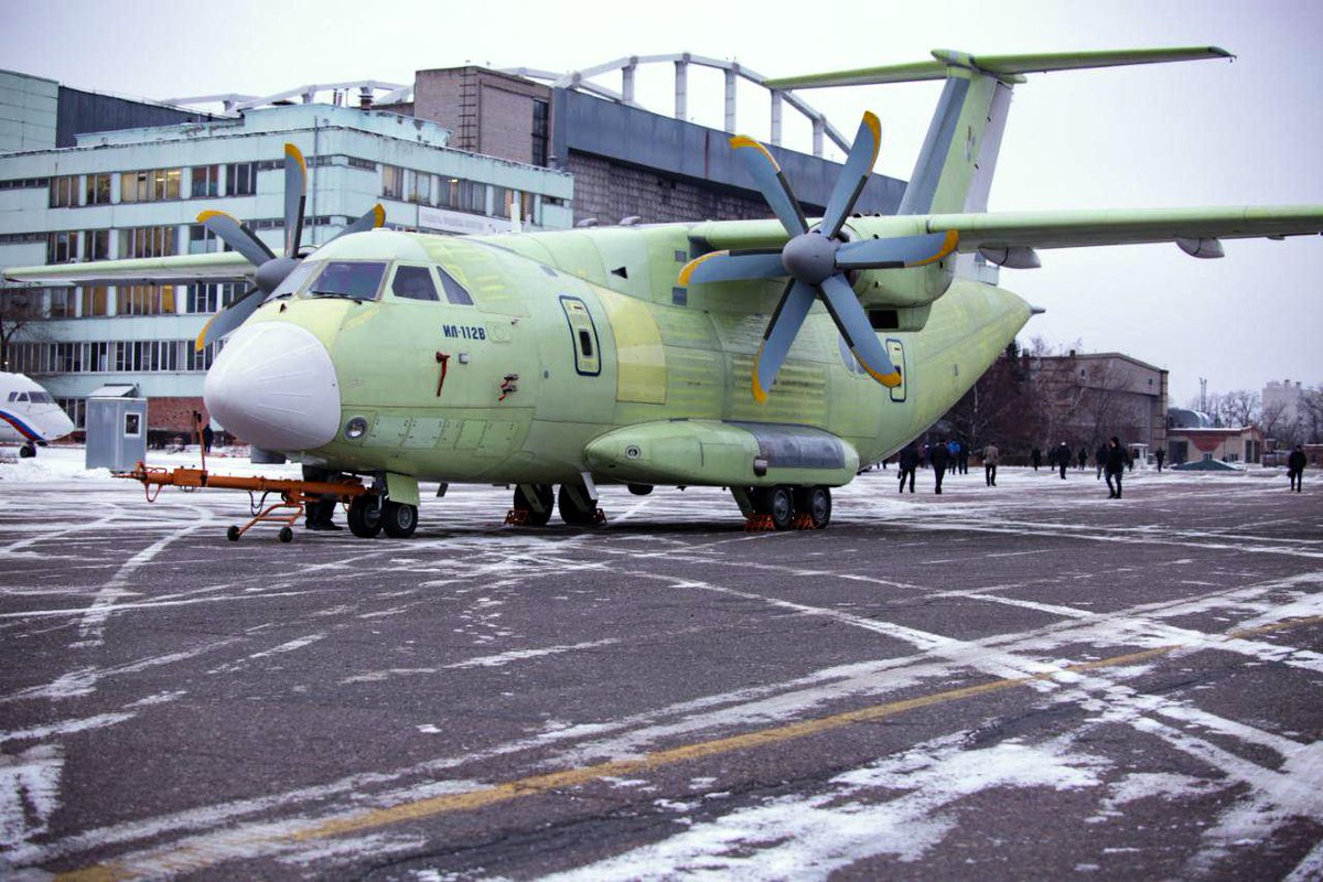

    First Il-112 assembled
    Il-112V light military transport  - Page 5 DtBOiZ_WkAE1vKj
    https://sdelanounas.ru/blogs/114576/
