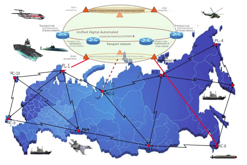

So lets try a harder one:
The extracted text looks like this:
Connection node
Networks of access to the resources of the transport communication network
Uzip
of joining
Transport hub
for access network maintenance
Unified Digital Automated
Transport hub
communication system of the Armed Forces of the Russian Federation
Transport hub
Transport network
a transport hub
for the maintenance
of access networks
PL4
Connection node
Networks of access to resources broadcasting
from
the dinen communication network
PL1
PW-10
rc-3
RC-2
RC-9
RC-6
Connection node
Uzip
of joining
Transport hub
Transport hub
Transport hub
Transport network
a transport hub
for the maintenance
of access networks
PL4
Connection node
from
PL1
PW-10
rc-3
RC-2
RC-9
RC-6
