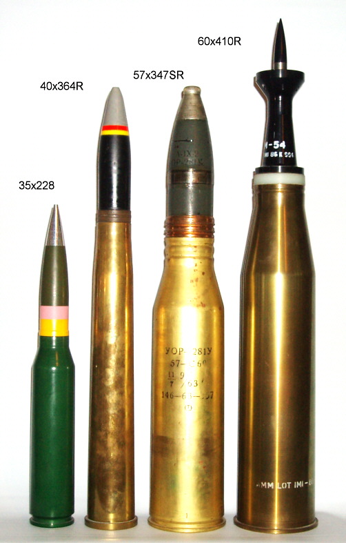

A primary advantage of the 57mm is guided shells offering the ability to take on a large number of incoming threats... ie UCAVs and UAV targets... 50 rounds or even 10 rounds per target and you are wasting an enormous amount of ammo... it is like having to fire 10 rounds of 125mm ammo for a kill... or a chance of a kill.
Roughly, doing the calculus for a 0.057x0.057x0.30m3 by round (assuming a lenght of the cartridge of 30cm, it means 0.916m3. I think that would not be difficult to find 1m3 inside the kurganets platform to have all it inside.
Sorry... what?
In this image look at the size of the 30 x 165mm shell that is fourth from the left in the image above.
Now look at the round at the far right... the 35 x 228mm round... see how it is about 1/4 bigger than the 30mm round?
Now look at this image... the tiny round far left is the 35 x 228mm round, and the 57mm ammo we are talking about is second from the right... the 57 x 347SR.
Now that is the old 57mm round but the new round might be a sophisticated telescoped round, or it might not, but its primary requirement will be an APFSDS round that can penetrate enemy IFV armour at battlefield ranges so the case might be even bigger than this to get the velocity and shell capacity needed for the jobs it will be used for.
I suspect they might go for a telescoped case and certainly a semi rimmed or rimless case, but I suspect bigger but better shaped to make it easier to use in automatic ammo handling systems.
the IFV will have about 300-350 rounds at most and the SPAAG will likely have maybe double that at 600 rounds... but with a very large percentage guided shells for the SPAAG and perhaps half to a quarter of the ammo for the IFV which will have more APFSDS rounds and HCHE shells for battlefield targets.

Well part of the problem is that a 57mm round is not a rectangle shape and will not fit inside the rectangle shape you describe.
The 57mm shell is more like 80mm square due to the shell case being a rather larger calibre than the projectile which you are using as a basis.
A comparison would be to describe the 5.56mm NATO round as being 5.56mm square and 45mm long... it is clearly not either of those things.
The 57 x 347mm dimensions of the round describe the diameter of the projectile (57mm) and the length of the shell case (347mm). That totally ignores the diameter of the whole round... ie the shell case and also the added length of the projectile that adds to the length of the entire round of ammo.
The length of the entire round is 536mm for the navy 57mm shell and looking at the photo I posted above the shell case diameter is more like 80mm using the calibre of the 40mm round sitting next to it.
Assuming no belt mechanism between rounds in the ammo handling system that would be needed to move the rounds from the ammo mag to the gun to fire the rounds then we are talking about 80mm square rectangles that are .54m long... so .08 x .08 x .54 x 940 = which is more like 3.2 cubic metres... and that is without the ammo handling system to move them to the gun and load them...
BTW 940 rounds would be just under 6 tons in weight too...

80mm cases for 57mm ammunition? Sincerly, if a case of 80mm is needed, better to make it 76mm ammunition. This is what has been done the last decades. For calibers of this size or bigger, I only see cases with a 40% plus of diameter in ammunition of 50+ years old (maybe 60+).
But even 3m3 seems not too much in a platform that allows to move 8 passengers (+3 of the crew).
The calculus that I did, was an approximation by excess generous enough to allow cases a little bigger than 57mm, if the ammunition is properly stored. The calculus of this approximation it is not the configuration for minimum space storage, only it is an easy and useful approximation.
For anti armour and anti aircraft use a large shell case provides lots of propellant... which is needed for high velocity.
You can make it a 76mm round but then the performance of the APFSDS round will be pathetic and its surface to air performance will also be mediocre.
The shell case capacity is what gives it the volume to allow for long rounds of guided projectiles while still having space for propellant to make it useful.
3 cubic metres is shells only... it does not include the mechanism for loading and moving the ammo from where it is stored to the gun.

The 57mm round is based on the old round... if they reduce the diameter of the shell case to the diameter of the calibre then there wont be any room for propellant unless the rounds are a metre long.
Assuming a shell case that equals the diameter of the calibre is just dumb... in the competition the 45mm round was revealed to be a telescoped case round while the 57mm round was based on an existing round... the 57mm round was selected because the projectiles are larger and have more capacity for different payload types.
For the same reason during WWII the T-34 entered service with a medium pressure 76.2mm gun instead of the competition which was a high velocity 57mm gun with much better armour penetration performance. The 76.2mm gun had better penetration at longer ranges but had a much more effective HE shell.
I suspect the result was no different comparing the 45mm and 57mm rounds.

57mm round has to be very fast over 1km/s , so it will have a big propellant charge ,and casing will be big by default.

You can find the rim diameter, projectile weigh, muzzle velocity of many ammunitions in this link here
The 57mm Soviet S-60 cartridge is much shorter (for higher rpm) and bigger (to keep volume of powder) than 57mm Bofors's. Like 40mm CTA situation, their big body diameter will take more volume that leads to less rounds than smaller ones like Bofors 57mm round in the same ammunition box.
