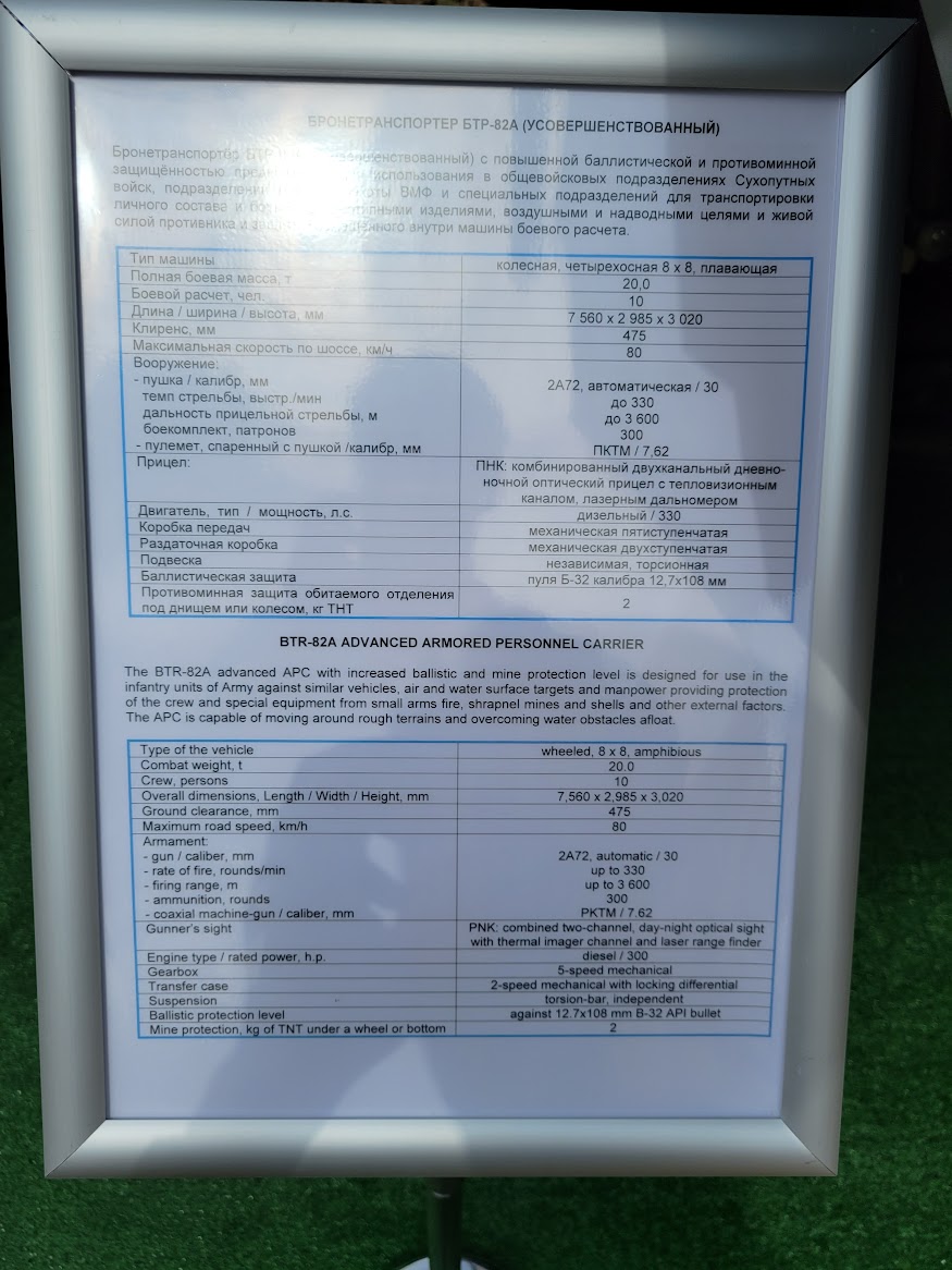

    Post  GunshipDemocracy Thu Aug 31, 2023 2:41 am
    TMA1 wrote:Looks like it is not amphibious at all.
    after Begome's post:
    "The APC is capable of moving around rough terrains and overcoming water obstacles afloat"
    BTR-80/82A and variants: News - Page 15 <a href=BTR-80/82A and variants: News - Page 15 10355210" />

    TMA1 wrote:Looks like it is not amphibious at all. I have mixed feelings. It is a very good looking upgrade and frankly Russia needs to focus on quantity as well as quality. That said I agree that Russia must move forward with new designs that incorporate and institutionalize new materials and methods into their manufacturing. This is why I feel the T-14 is vital. Even if it turns out it isnt massively better than t-90m it incorporates so many new materials and concepts that these all must be institutionalized into their MIC so that they arent just stuck with R&D paper projects. Does this make sense at all?
    Probably for export only.

    GunshipDemocracy wrote:
    BTR-80/82A and variants: News - Page 15 10357207_1000
    So it is amphibious after all Smile
    Retracting my statement that it's perhaps for export only Cool
