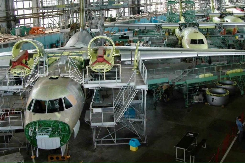

AMCXXL- Posts : 790
Points : 790
Join date : 2017-08-08
- Post n°510
Re: Il-112V light military transport
Podlodka77 wrote:
And the An-72 is approaching its operational end also in the near future.
That A-400M aircraft is again significantly more expensive than the C-130 and An-12. The An-70 does not have a long enough range to compete with the Il-76MD-90A because the An-70 with a payload of 38 tons has a range of a few hundred kilometers less than the Il-76MD 90A with a payload of 60 tons. Therefore, the workhorse and basic transport aircraft of the TA VVS remains the Il-76.
Considering the area of Russia, I would still go for the variant that has the highest load capacity of 20 tons or from 20 to 40 tons. Il-112 is excellent, but only for paratroopers and VDV, while the carrying capacity is insufficient, at least if we consider the transport of military equipment. Il-112 is good for transporting soldiers or paratroopers, as well as for transporting food or ammunition of small weight.
I think a smaller aircraft than the Il-76 would be an excellent option for the VVS, but I would rather go with the Il-276 than the Il-112.
Of course, this is just my opinion and therefore not authoritative.
IL-276 is cancelled, it is not a viable project to manufacture 50 units, while the Il-112V is "frozen" due to problems, besides being an insufficient aircraft
I do not expect new transport aircraft for the VKS in many years, it is not a priority, proven Soviet models will continue to be manufactured
When the Special Military Operation is over we will see what they do in this matter, but the safest and most convenient is to manufacture An-74T-200 or similar new version
An-72 will still operate for a few years and not only in VKS, but also in the Border Guard and other bodies.
They are the newer aircraft compared to An-12 and An-26 and some have been in reserve to extend the life of the resource
Irreplaceable in operations in the Arctic
It will be easy to achieve you have facilities, personnel who can train new technicians and workers and also almost all the components of the plane

Anyway, as far as An74, the issue is if Russia has other aircrafts or is planning other aircrafts to operate specifically on artic condition. I know that they recently landed in Antartica with an Il-76, but that is a much bigger aircraft.
As far an eventual restart of the production, they would have to see if they can do what has been done for the il-76 and il-114.. digitalise the design and adapt to new engines/ avionics, etc.
Also they could see if the partially built an74 are salvageable, or if they have been destroyed.
