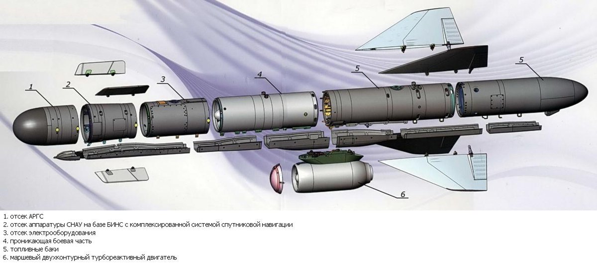

JohninMK- Posts : 10841
Points : 10962
- Post n°307
Re: Anti-Ship Missiles Thread
Missile Tidbits
@divert_thruster
Nov 2
Cutaway diagram from Russia's KTRV Tactical Missiles Corporation shows the Kh-59MK anti-ship missile in detail. Unlike earlier variants, the KH-59MK uses an active radar seeker and has a 285km range, and has seen modest success in export markets.
