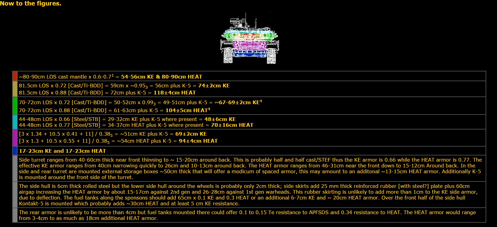

    Post  Werewolf on Tue Jan 27, 2015 5:01 am
    TR1 wrote:Werewolf's numbers are baloney.
    And that quote is Fofanov, saying Obj 195 was the answer to M829A3. Since you know...that round did not exist earlier. Obj 187 was made with newer rounds in mind as well, especially post M829A1 ones.
    Fofanov explicitly says a new tank was the answer, not modernized ERA that entered service before the A3- AND HE IS NOT TALKING ABOUT K-5! He is talking about Relikt.
    But somehow you guys believe the delusion that T-72B3 can withstand A3 hits anywhere it has ERA.
    Baloney is what you try to portray it here, those are numbers from FOFANOV which you have quoted here already, meaning you trust his work and those numbers were only from him.
    Since you clearly have added or better to say ignored half of what i said and just jumped on the phrase which you seemed the most convinient to comment, ripping it out of its context making it a baloney debate and not a discussion.
    Since you already have aggreed that Fofanov is also your source so lets keep it the same way.
    T-72B on his page for upper glacis like i have posted before has 720mm RHAe against KE, the M829A3 have around 680-690mm at 2km, the K5 highly capable ERA is already explained on Fofanovs side that it can destroy long rods, destroy the hardend tip and make them yaw from the explosion, decreasing their capability. Since you clearly have ignored and not even mentioned in the replies this sentence which is the entire point of discussion you ignore everytime so far,
    The T-72B3 with K5 is well enough protected against M829A2 and A3 to common and effective tank engagement ranges, that makes them effective for engaging other tanks, this are not some iraqi monkey models that couldn't penetrate even weak spots with their 290mm RHAe training APFSDS-T rounds from 10m distance. The T-72B3 can not just enter the the effective tank engagement round but also deploy weapons outside of the M1A2 SEP. I've never ever stated nowhere that it is immune, it is not, but the M1A2 SEP would need to get within 2km and below to destroy the T-72B3 unlike with iraqi Monkey Models which could have been destroyed by M60A3 from 3km range without problems.
    Either you keep it to what it was intented a discussion or you further go down the track of pulling it down to a debate with personal crusade.
    You know exactly that it can withstand tank rounds at engagement ranges and can also engage tanks far beyond the iraqi 1500m (day vs static).
    If you haven't followed this thread here, it was not me who started to compare B3 with A2, it was asked to be compared by another user, most likely he wanted to know how it fares to compare it with the so "legendary" Abrams against allegedly "soviet" T-72's in Iraq.
    And yes the gas turbine is a big flaw and your notions that the T-80 has them does not change this very fact that gas turbines on tanks are shit, this is also proven by every single country even russia has abondoned gas turbines and USA does too with M1A3 model getting a Diesel engine. They don't do it because of any other reason as mentioned before, it is shit and damaging the tanks value on battlefield.
    Besides... Not like the M1 would ever reach the ground, knowing that the smallest transport aircraft that can take it is the ****** huge C17 that would get nailed before it lands.
    As opposed to T-90 right, which is only carried by An-22s and An-124s.
    Well weight is a big factor at deployment, while russians actually can airdrop T-72/90 and have all necessary equipment for it, US can't do and a heavier tank does not make it easier. Logistically the M1 is the worst, uneconomical, disastrous and depends in more situations on the supply chain more frequently than any other tank, thanks to gas turbine and its enormous weight.

    @TR1
    Assuming the A3 hits the K-5 it won't penetrate almost for sure. The A3 only has ~670 mm of RHAe penetration, versus K-5 plus the comp. armor on the -72 it shouldn't have much of a chance. That being said, if the upper glacis of the B3 is de-angled to an extent, the A3 should have no trouble you get the idea.
    According to CIA reports, the T-72 (note that this is the *base* model with *no* ERA) couldn't defeat the Soviet's own top-notch KE rounds, but that it could defeat their own HEAT rounds. When you include K-5 into this situation... I seriously doubt either the Soviet/Russian or American rounds could reliability pen its upper glacis. I can't really confirm this but from what I've seen, the upper plate of the B3 with K-5 has a RHAe of ~700+ (KE) and ~1200+ mm (HEAT).
    we are only working with conjectures here, so is it not fair to also assume that the a3 would work as advertised against K-5 ERA? remember K-5 is just first serial ERA that is "heavy"/with anti-apfsds properties, wouldnt take long for the other side to have a grasp of a reliable counter against relatively noobish design principles for new class of "heavy" era. the newer and more sophisticated relikt (kind of an oxymoron, really) should push back the tide, and then along comes a4, but i doubt a4 can help much, esp. since the abrams gun system is getting old- modernized sprut-sd should have much better gun than even latest m1a2, hahaha.

    sepheronx wrote:Then, let us post the numbers.  It is better to show evidence rather than just talk.
    I already did so his now butthurt and contradicting his own trusted source, he prefers words of a prototype over evaluated numbers of his own source.
    http://fofanov.armor.kiev.ua/
    T-72
    numbers are:
    Comparing tanks - Page 3 Pv4vxpiy
    The entire discussion was if the T-72B3  upper glacis can withstand M829A2/A3 at first engagement ranges or effective engagement ranges 2000-2500m up to 2800-3200m for M1A2 SEP.
    The figures of the M829A3 are also not that magical in comperision with M829A2 only slight difference of 680mm ±10mm RHAe at 2km.

    Hate to rag on you TR1 but we've been the ones with the numbers... If you're gonna try and prove a point, then prove it with proof and not beliefs.
    Werewolf, I thought that was the T-90's armor profile (looked it up the other day?)?
    Russia has modern KE rounds in development, but it is a royal PITA to find any info on them. The newest round shown in the public had above 800 mm of pen if I remember right.

    Post  Werewolf on Wed Jan 28, 2015 12:27 am
    Mike E wrote:Hate to rag on you TR1 but we've been the ones with the numbers... If you're gonna try and prove a point, then prove it with proof and not beliefs.
    Yes this picture is a T-90 the figures are from Fafonov from T-72B, just look on his page.
