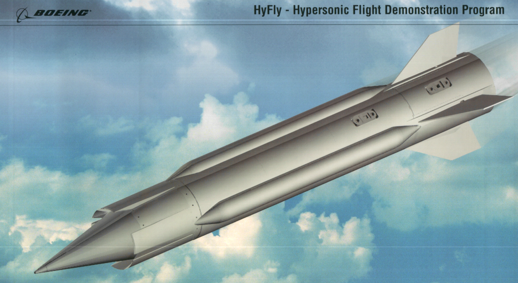

    Saw that elsewhere along with this
    Note the logo on the thing in the video.
    Thats some real Russian trolling respekt
    Edit: hmm interesting thing http://www.designation-systems.net/dusrm/app4/hyfly.html it is actually a dual-mode ram/scramjet in a missile.
    Frankly I have been doubting the practicality of doing that but apparently it can be done. (albeit appears to have failed...)

    I watched through the entire video with help of google translate. Unfortunately, the picture referred by TheArmenian isn't probably Zircon but the DCR model of American HyFly program. The segment (starting on 30.37 minute mark) when they show the model was about doing and testing scaled down radar models of Western equipment so that when they look on VKO radar screen for real, they can do educated guesses on what it is.
    The presenter did troll Western audience in that particular segment though, going on like "they never completed it" and "Sorry western warriors" which could refer to keyboard warriors that might be enraged that the evil Russians are doing copies of notional Western stuff like F-18 to F-35 and GBI missile. Laughing
    The only difference between a ramjet and a scramjet is the fact that a scramjet can burn fuel at supersonic speed... otherwise they are both ramjets.
    This suggests that a scramjet should be able to operate in ramjet mode at low speed....
    Otherwise what you are suggesting is that a turbojet that flys at mach 2.8 like the engines in the MiG-31 could not possibly be started on the ground at zero speed and operate at less than 500km/h during takeoff and landing... when clearly they do.
    I doubt they would be very efficient if they never went faster than 500km/h but that is not to say they don't work at those speeds.
    It looks very much like an air launched Iskander, but then being air launched there are no limits on speed or range... which shows you the potential of the ground launched missile... of course mach 10 is simply too fast for a rocket that size and 2,000km range means it is most likely fitted with a scramjet sustainer, unlike the Iskander...
    You need to reconfigure the shape of the combustion chamber between the two modes because the energy cycle is different.
    Not impossible but complex -> likely to be heavy, expensive & possibly unreliable so seems unlikely to do in a missile instead of a simple rocket booster to get it up to scramjet speed.
    Maybe Boeing found a relatively simple way to do it though dunno
