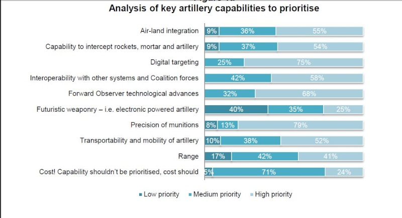

    Russian Gun Artillery: Discussion Thread - Page 2 Empty Analysis Of Key Artillery Capabilities To Prioritise
    Post  Sujoy on Thu Jan 24, 2013 12:54 pm
    Russian Gun Artillery: Discussion Thread - Page 2 Untitl14
    I found this analysis on the brochure of a Defense Conference being held in the UK . This analysis offers an indicative examination of artillery requirements over the next ten years .
